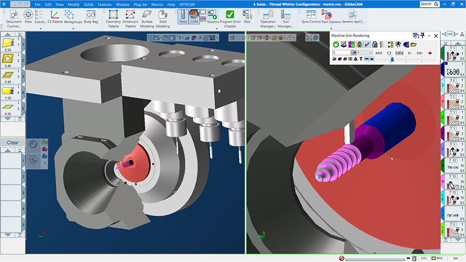

Swiss machine tools represent some of the most diverse and complex machine tool configurations available today. With GibbsCAM GO Swiss, your machine tool’s specific configuration is captured by GibbsCAM’s factory-supplied settings. You can be sure that you are accurately programming all your machine tool’s capabilities and taking full advantage of maximum productivity. You can also quickly switch a machine from one set up to another, such as switching a thread whirling head with a tool post.

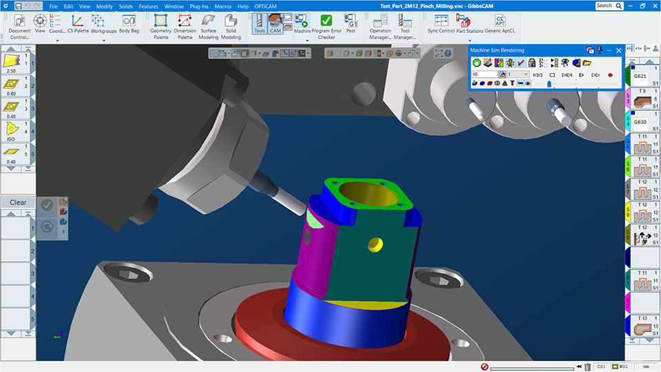

Machine-specific setup
Intermediate tooling provides more accurate simulation of cutting motion

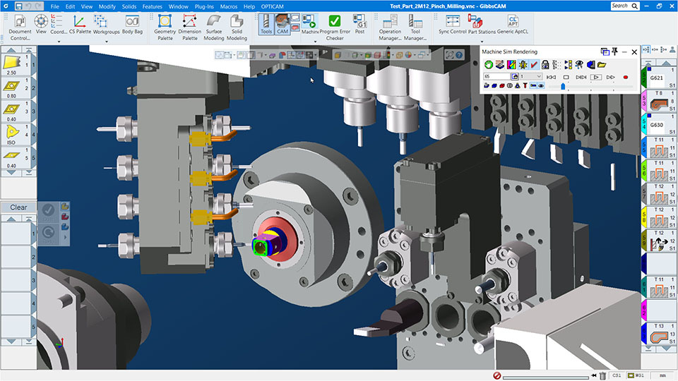

Program machines with any number of turrets and spindles
