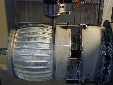

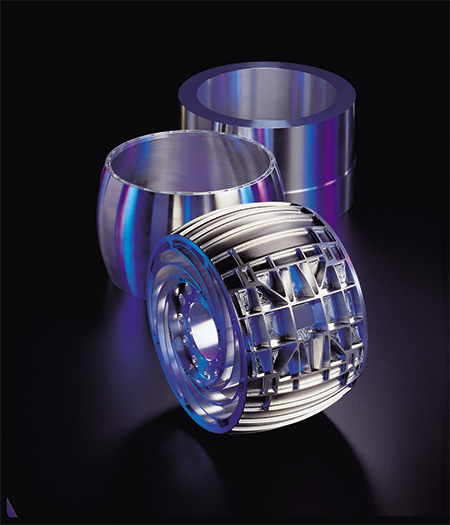

The wheels were also a considerable machining challenge because of tight engineering requirements. Wall thickness on the Mars Rover's wheels had to be tightly controlled on every surface of the part. Dimensions were constantly being pushed to keep the material as thin as possible without affecting the structural integrity designed into the wheel. Maintaining the structural integrity was a top priority. This required constant communication with JPL and a clear understanding of specifications. "It is pretty incredible when you think that a 64-lb piece of material ends up weighing 2.25 lb," adds Babcock. The geometric complexity of some of the parts reflects the creative design that packs a lot of engineering and scientific capability into a relatively small spacecraft payload.

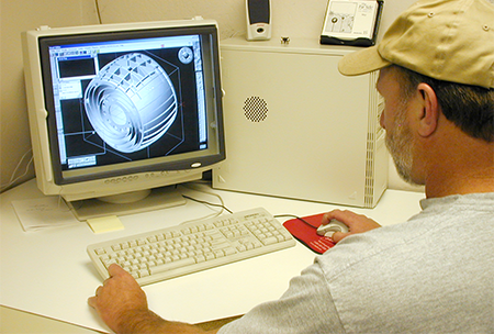

The combination of science and technology will continue to stretch the limits of what can be done, but the real challenge comes when trying to make these ideas a reality– a physical reality. "Cut Part Rendering in GibbsCAM has become a critical tool for working more effectively both on the engineering and manufacturing sides of a project," says Chris Baker, Next Intent's manufacturing manager. Within the GibbsCAM software, the Cut Part Rendering feature essentially allows the programmer to run a complete computer simulation of the machining job before sending it to the shop floor for actual machining. Based on the simulation, the programmer can then make modifications to optimize the job or fix problem areas that were not detected initially.
Next Intent takes this information to the next level by creating a series of key screen captures, which become a part of the machining documentation and process control. "We have our programmers review the machining documentation with the setup operators; this ensures everyone is on the same page,'' says Baker. And Cut Part Rendering helps Next Intent's team communicate more effectively with its customers, especially regarding the physical constraints of design.
"Sometimes, we see tooling constraints in a part where the radius or blends are complex. From just viewing the model in SolidWorks, we will think 'yeah, we can machine that.' However, once we get into Cut Part Rendering and see the cuts simulated in detail, we discover problems, such as inappropriate tool lengths or tilt angles or any number of issues," says Babcock. "When our programmers provide these pictures from the actual machining simulation from within GibbsCAM, it helps the design engineers see the part from a machinist's standpoint, and also exactly where the model is causing difficulty. After our customer sees the problem from our viewpoint, they make the changes to the model-with no bickering! A picture is truly worth a thousand words."

From start to finish, the Mars Rover wheel requires about 25 hours of machining time.
