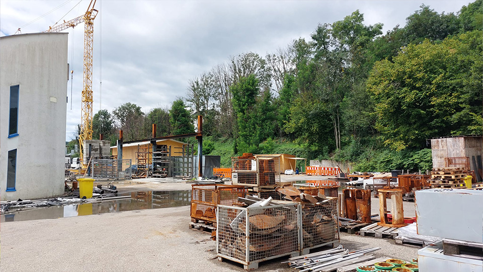

construction crane
The construction crane still dominates the image of the new production facility. Until completion, production takes place in a temporary hall on the site (in the background) and at another location.

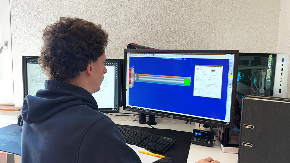

MUT-Tschamber has a longstanding history of using tools from Sandvik Coromant. In 2022, they explored the capabilities of PrimeTurning™ technology in collaboration with their regional partner, HeRo Werkzeuge & Maschinen. “At that time, we immediately recognised the potential of the technology for us and decided to investigate further,” claims Yannik Tschamber, Junior Technical Manager. “We then had the opportunity to take a look at the machining process live at the Sandvik Coromant Centre in Renningen and it became clear to us that PrimeTurning™ would help us to massively increase our productivity. It was also clear that we needed a new CAM system for the successful use of the new technology as we had been programming directly on the machine control.”
SMEC SL 4500 SM in GibbsCAM
The machine simulation of the benchmark part on the digital twin of the SMEC SL 4500 SM in GibbsCAM ensures the highest process reliability.

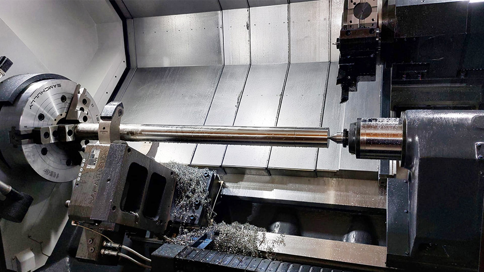

Benchmark shaft on the SMEC 4500 LM
The benchmark shaft on the SMEC 4500 LM. The machine is equipped with a main spindle, NC-controlled steady rest and tailstock and a 12-station turret (with 4 stations for driven tools) and is ideally suited for shaft machining up to 3m in length.
MUT-Tschamber explored various options but found a perfect fit in GibbsCAM after a recommendation from a Sandvik Coromant employee. The software’s optimal support for PrimeTurning™ strategies and the CoroPlus® Tool Library made it a compelling choice.

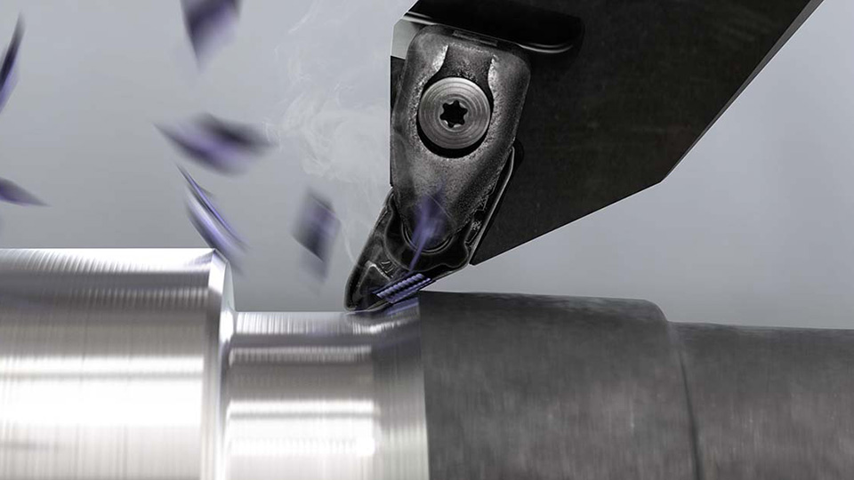

METHODOLOGY: PrimeTurning™ uses inserts with a negative rake angle in combination with a special toolpath.
TOOLS: The PrimeTurning™ method requires specially developed CoroTurn® Prime A & B tools for roughing and finishing.
SOFTWARE: The GibbsCAM integration of PrimeTurning™ has been verified by Sandvik Coromant and includes all programming codes, tool models, cutting data and techniques for setting the correct parameters and variables.
The negative rake angle of PrimeTurning™ produces a wider and thinner chip. This chip thinning effect allows significantly higher feed rates compared to conventional turning. While the advantages of a negative rake angle have been known for a long time, access to tight corners used to require two to three tool changes to prevent the cutting edge of the insert from completely touching down when plunging into the corner. The combination of PrimeTurning™, CoroTurn® Prime inserts and GibbsCAM programming cycles now enables machining in tight areas with a single tool. To do this, the corner is first cut free in a special cycle with the same tool. In the process, GibbsCAM uses variable feed rates.

Comparison of Conventional Turning vs. PrimeTurning™ (on the right): Negative rake angle and pulling cut result in longer tool life, prevention of chip congestion, and higher cutting performance.
Sandvik Coromant PrimeTurning™
A small automatic intermediate step in the GibbsCAM PrimeTurning™ strategies prevents contact of the full cutting edge on the part. The image depicts the step in the simulation after clearing (Toolpath 2), before the insert plunges to the final depth (Toolpath 4).
The advantages that result are far-reaching. Tools have a much longer life due to better heat dissipation, the use of a larger area of the cutting edge, and the even use of multiple cutting edges of the insert when working in multiple directions. In addition, the risk of chip accumulation is eliminated by the drawing cut. Thanks to increased metal removal rates, more parts can be produced per unit of time. The time required for set-up is reduced, as is the number of tool changes. By using PrimeTurning™, companies achieve a rapid return on investment. Higher productivity and lower capital costs result in a lower total cost per part.

In August 2023, a benchmark was conducted at MUT-Tschamber to evaluate the effectiveness of Sandvik Coromant’s PrimeTurning™ process incorporating CoroTurn® Prime A & B tools and GibbsCAM programming. They machined a 1.4529 stainless steel insert shaft measuring 1485 mm in length and 80mm in outer diameter on the SMEC SL 4500 LM. When compared with their previous machining methods, the PrimeTurning™ process demonstrated remarkable advantages, including a 40% increase in cutting speeds, more than a 3.5x boost in feed rates, and a fivefold rise in metal removal rates. The tool life of Sandvik Coromant’s CoroTurn® Prime tools proved to be three times longer than other inserts, resulting in a quick return on investment.

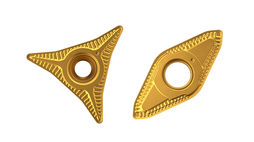

The CoroTurn® Prime A&B inserts
The CoroTurn® Prime A&B inserts from Sandvik Coromant excelled in the benchmark with five times the metal removal rate and three times the tool life.

In addition to the advantages offered by the optimal integration of Sandvik technology into GibbsCAM, a number of other features were also decisive in the implementation of the new CAM programming software. GibbsCAM’s intuitive interface and robust simulation capabilities left a strong impression on MUT-Tschamber. Yannik Tschamber was responsible for the benchmark and reports on other factors in the decision: “From the very beginning, we were particularly impressed by the simple and intuitive operation of the GibbsCAM system. In addition, the simulation options are decisive for us, above all, the fact that we can use it to simulate the complete machine kinematics, including auxiliary operations such as the movement of the tailstock and steady rest. We have a real digital twin of the machine here, with which we can achieve maximum process reliability.”
From the very beginning, we were particularly impressed by the simple and intuitive operation of the GibbsCAM system... We have a real digital twin of the machine here, with which we can achieve maximum process reliability.
Yannik Tschamber, Junior Technical Manager, MUT-Tschamber
Continuing Yannik Tschamber says, “We are sure that with GibbsCAM we have purchased a CAM system that we can use universally. It is important for our company to be prepared for future investments. With GibbsCAM, we have no doubt that it is also prepared for future requirements. The Sandvik Coromant and GibbsCAM teams were really fantastic in their preparation, enabling us to produce the specified shaft on site on our machine in less than a day.“
