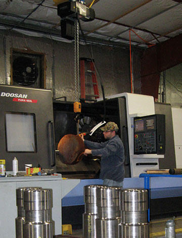

This lathe machines the company’s larger rockdrilling bits, including some that went into drills sent to rescue the miners in Chile.

Specifically, the company has a “done in one” machine tool—a Doosan Puma Series MX 2500 ST turning center featuring both a secondary spindle and live tooling. On this machine, a drill bit part could conceivably be taken all the way from raw forging to the heat-treat stage within a single machining cycle, rather than the series of setups needed to produce large bits such as the ones that went to Chile. However, the shop doesn’t necessarily opt for the one-setup approach.
That machine is part of a spectrum of turning equipment in the shop, with the level of multitasking capability increasing as part sizes go down. The newest machine in the shop is for turning only—a Doosan CNC lathe with a maximum turning diameter of 22 inches. A mid-size machine from the same builder offers live tooling but no secondary spindle.
With these machines, Center Rock is exploring the right level of multitasking for its parts. One of the lessons Center Rock shows is this: Just because the company can produce some of its bits with very few setups, that doesn’t necessarily mean that it should.

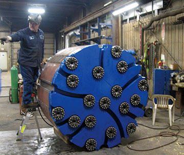

A drill sometimes includes many bits for cutting the rock, as is the case with this one about to be welded in the company’s fabrication area

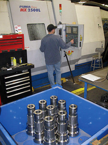

This turning center features live tooling capability. Another turning center for still smaller bits features live tooling and a secondary spindle.

Smaller rock-drilling bits see fewer setups than the sequence described above. This is because of the combined turning and milling capabilities of the shop’s smaller turning centers, which allow the company’s most popular drill-bit sizes to be run more productively. The smallest-diameter bits could be machined (up to the point of heat treatment) within a one-setup process. Given that a single drill requires fewer than 20 bits (often fewer than 10), this might seem like the best method. Yet the shop instead frequently machines its small bits across a series of setups, with work sometimes proceeding through the shop in batches of 100 or more. From Center Rock’s perspective, why does batch manufacturing employing a sequence of setups remain the better approach? The answer to this question is potentially useful for any shop that is evaluating multitask machining capability.
As Center Rock shows, this capability is valuable for reasons that go beyond just single-setup machining. The freedom to perform more machining in one place enhances Center Rock’s production capacity, even if that freedom is not used to machine a part all the way to completion. For example, the smallest bits often receive stem-end turning, pilot hole drilling and spline milling in a single, efficient turning center setup. However, the cycle then stops.

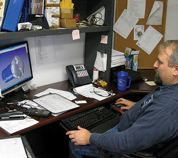

Steve Bungard demonstrates one of the machining operations for a drill bit part in GibbsCAM, which the shop uses to program both turning machines and machining centers. More about Center Rock’s machining process is documented in the episode at edgefactor.com.

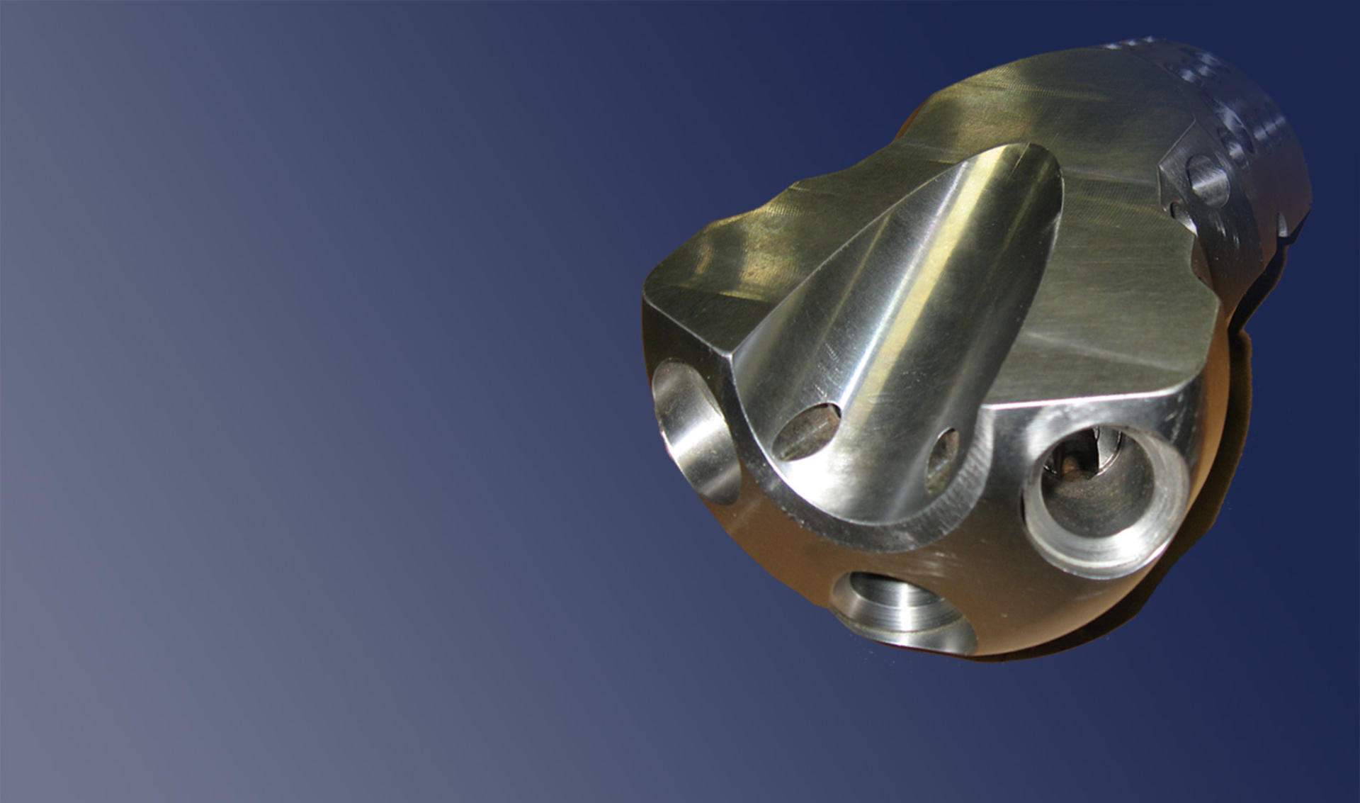

  2. Response time. The machining left out of the cycle above includes the geometry of the face. This is the part of the bit that varies most from drill to drill. Often this face geometry is custom. Therefore, in order to respond to customers quickly, Center Rock machines everything except the face geometry and keeps the semi-completed bits waiting on the shelves. Keeping this stock does not add much inventory cost because of the next point.

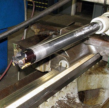

The company developed its own process for drilling the deep blind hole in each bit. Key to the process is the Sandvik Coromant Corodrill tool that allows coolant and chips to be drawn through the tool and out of the hole.
