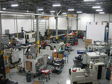

Harmonic Machine's facility houses the latest technology and the company practices lean manufacturing to meet customer demands.
