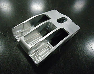

All Mathews metal components are machined from aluminum, and 75% of the machined components, like this limb cup, which connects riser to limb on the Creed XS hunting bows, are made on a multi-part tombstone programmed with GibbsCAM TMS.

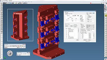

Programming all these parts for machining would be a real challenge, but as John Jerome, Mathews’ most experienced CNC programmer explains, their GibbsCAM software includes the TMS (Tombstone Management System) option, specifically designed to simplify programming multi-part fixtures. He begins by loading the entire assembly into GibbsCAM, then removes any detail he doesn’t need for programming and simulation.
Window fixtures provide access for cutting tools to reach the workpieces from additional directions, reducing the number of times a part needs to be clamped for machining. The back of this tombstone shows six parts through the windows after a machining cycle.
He also explains that programming with TMS provides quality, efficiency, speed, and a little safety. “In your initial program run, you just cut one part, make sure it’s great – a couple of text boxes later, you’re cutting a whole tombstone’s worth of parts,” he says. “You gain consistency across the whole part run – if it’s three pairs or 120 parts, they’re all identical. You also gain another advantage, because TMS makes you set your clearance and retract planes, so you don’t need to worry about crashing the tombstone while it’s rotating.”
