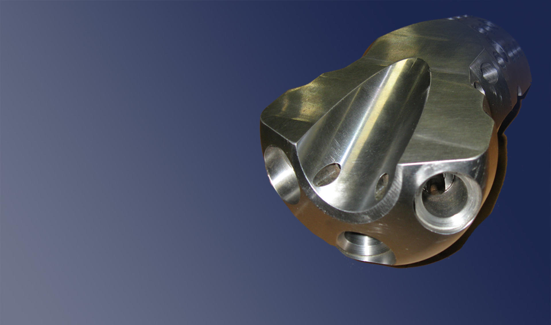

Webber uses heat-treated 4140 steel to make several types and sizes of rock-drill bits, ranging from 2 inches to 9 inches in diameter, up to 15 inches long, all enabled by multi-axis machines and GibbsCAM programming.

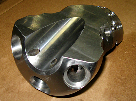

Machining the header requires boring numerous holes of small diameters at specific angles and precise locations. Repeatability and 0.100

The Mori Seiki NT machines and GibbsCAM have enabled Webber to eliminate setups and reduce operations. Parts that once required two turning operations and four to six milling operations are now done in one. Additionally, Webber now makes parts it did not make previously. Using the NTs, they are filling repeated orders of 10 to 50 pieces of rock-boring bits made from heat-treated 4140 steel. The parts range from 2 inches to 9 inches in diameter, up to 15 inches long, and have flats, bores, threaded holes, surface machining, pockets and undercuts, and are all made with two operations, one on each spindle, and take 2 to 3 hours to machine.

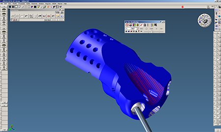

Aside from the multiple programming features of GibbsCAM, Mr. Brackemyer relies on Cut Part Rendering and Machine Simulation to check part finish, ensure no gouging or unwanted cuts, and confirm that tool and part motion are correct and not causing collisions.
Multiple features of both software and machines accrue time savings, but two features of the software that Mr. Brackemyer relies on for multi-axis programming are toolpath verification and Machine Simulation. These features provide the final prove-out before sending CNC programs to the machines.
“GibbsCAM Cut Part Rendering lets you compare your cut part with the stock body to determine if you’re cutting where you shouldn’t be, or if you’re gouging. Also, you can save what you have from a previous operation as a faceted body, and use that as new stock. It’s really handy for multi-axis and whenever you have multiple setups or have to move the part from machine to machine.”
Machine simulation shows the inter-relationship between the cutting tool, the part, fixtures, and all moving components of a machine. Webber has not created models of the machines for this purpose, but uses machine simulation to show how the tool approaches the part and how the part rotates. In combination with Cut Part Rendering, simulation provides assurance before actual machining.
