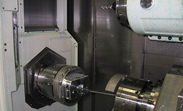

Machining the grip body requires no turning work, but the Mazak Integrex, as programmed with GibbsCAM, enables machining the entire part in a single set-up. It begins as round stock, as shown here, in the main spindle, ready for transfer to the subspindle for completion. Machining on a multi-task machine, saves 6 hours of set-up and cuts machining time from 111 minutes per part, to 43 minutes.

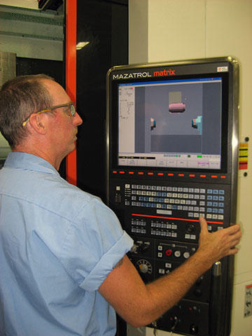

Todd Card, Instron first shift senior NC machinist, sets up a job on the Mazak Integrex. Because Mr. Welch prefers to keep the machine’s carousel loaded with tools for machining aluminum, it takes Mr. Card no more than 5 minutes to set up a job, unless a chuck change is required.
