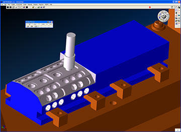

“I rely heavily on GibbsCAM’s visualization,” he said. “Just as I use Solid Edge to visualize design models, I use GibbsCAM to visualize toolpaths, and with GibbsCAM’s Cut Part Rendering, I visualize and check surface finish and minimize wasted tool motion.”
McCray was able to visualize the trunnion model, move it to other coordinate systems, check clearances, and design for the largest work envelope. He relied on the GibbsCAM Machine Simulation module for verification and optimization. To reduce modeling time, he got a GibbsCAM model of the Fadal from a friend, modified it, and “mounted” his trunnion and indexer, running simulations to verify travel, trunnion rotation, and workpiece size.
“It was awesome,” McCray said. “After simulating NC programs in real time, I was as competent as I am with the other Gibbs visualization tools. I started machining parts.”

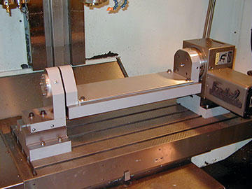

McCray recently completed the project with a solid and functional trunnion, which incorporates 86 individual parts, including fasteners, machined from 2" thick, 4140 steel.
The requirement for flexibility was met with removable subplates, which allow fixturing castings, as well as standard workholding devices.

“We can mount anything we want on a single subplate,” McCray said. Different subplates can be used for specific applications. The 24" work envelope allows a full 360-degree swing of an 18"×18"×9" block.
McCray said the weight of the design does not sacrifice accuracy because it is suspended by the head stock and indexer on one end and the tailstock on the other
“The unit is so tight and rigid,” McCay said, “that it holds the same tolerances as the machine and indexer.” He credits this to trunnion rigidity, built-in centering adjustments, and GibbsCAM positioning.

The trunnion’s head and tailstock are adjustable in two axes, about 0.1", to make exact centering on the table easier than tapping and tightening mounting bolts in the T-slots. The unit is rotated in one direction, indicated, rotated in the other, and indicated. If it’s off center, it can be dialed in.
The unit is routinely tilted in one direction and then the other and holds half a thousandth in either direction, with repeatability.
“Even when we have to machine to a given line, tilting in both directions, we still hold position to 0.0005", and we never use the brake to hold the indexer,” he said. “It’s as good as the machine and indexer. Most of the trunnions available are loose, made for cutting soft materials, and not very durable. With ours, we can cut D2 steel.”

GibbsCAM Cut Part Rendering

“We cut machining time 50 percent, because we didn’t have to move parts in and out,” Perdue said.
The trunnion’s first benefit was the elimination of hundreds of setups each week. With the ability to rotate to any angle, five faces can be machined with a single setup. The trunnion permits mounting several workpieces at once, reducing downtime in production machining.
As a second benefit, it eliminates use of form cutters, required on the old mills, for cutting angles.
A third advantage is, that by its design, it provides the flexibility to mount castings or raw stock as needed.
The greatest reward is that the trunnion, on a single Fadal 4020, made parts the first day it was mounted, and eliminated the use of eight manual horizontal mills within two weeks, which freed manpower. The machinists previously running the old mills are now running vertical machining centers. In weekly resource reduction, 320 machine hours and 160 man-hours went to 40 hours of each, or an 87 percent and 75 percent reduction, respectively.
