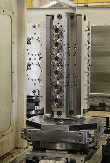

“It’s the ability to import Solidworks assemblies into GibbsCAM that gave us the increased ability to have our tombstones and our fixture plates, along with our components, all in Solidworks,” Remillard explains. “What I do is take a fixture plate that we’ve designed, import a part onto that fixture plate, then import it into GibbsCAM, generate the machining processes in GibbsCAM creating a .vnc file, and then import that file into the Tombstone Management System, which has our tombstone already modeled up, and orient the fixture plate onto a desired face. Then I tell it how many parts will be in the run, and how many faces. I worked closely with WestCAM to create a custom post processor; I gave them the center of rotation for our machine tool so when I post the program it generates all the G10s for the work offsets, which will write them to the work offset tables when the program is initiated. It’s very simple, in a way. We measure all our tooling from gauge line, so the operator can just concentrate on loading everything onto the tombstone, and when the tombstone goes into the work zone there is no operator intervention after that, other than maintaining offsets and tooling.”
Custom-built tombstones loaded in the DHP 5000.
Westcoast designs and builds its own tombstones and fixture plates to ensure accuracy. Although Remillard says that the company isn’t as automated as the team would like to be, this was an important step towards becoming more automated.
