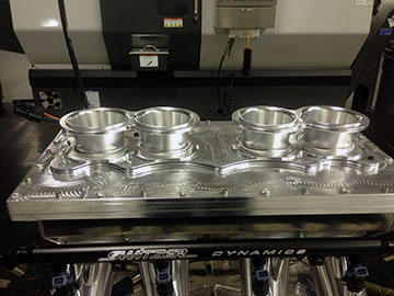

Manifold valley and flanges machined from billet show the pattern VoluMill creates when it generates the most efficient toolpath motion for running at maximum RPM and feed rate, while machining the 1/2” deep pockets in a single pass. Switzer leaves the machined finish to demonstrate part quality and beauty.

A fuel injection manifold that Switzer Dynamics makes for ReherMorrison Racing Engines (Arlington, TX) that was previously made with sheet metal fabrication illustrates the capability of VoluMill. The deepest cut they make for three-axis manifold machining is 1" (25.4 mm), although most of the pockets on valleys and flanges are 1/2" deep. Instead of programming conventionally with two to four passes of 1/4 to 1/8" (6.3–3.1-mm), Switzer programs a single pass at full depth and full speed for everything, relying on VoluMill to generate a smooth toolpath.

Although VoluMill has tables of suggested parameters, feeds and speeds, Switzer does everything based on chip load, running at maximum spindle speed and maximum feed rate. “I enter the tool diameter, the number of flutes, and my desired chip load per tooth, and VoluMill does the rest,” said Switzer. “It’s easy, and it’s really fast.”
