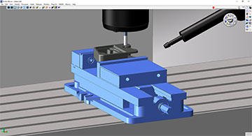

Advanced software features enable The Machining Center’s machinists to save machining operations, tools, speeds and feeds, and even setup models.
“The software combination of SOLIDWORKS and GibbsCAM has been fantastic,” said Vreugdenhil. “We model in SolidWorks and store the files in SolidWorks Vault. Programmers retrieve models from the Vault with GibbsCAM and create toolpaths directly off the model or selected geometry. The headlight fixture created a big surge in work from that automotive customer.”The software implementation works well with the shop’s process, which differs from most shops. Although the person who performs CAD is dedicated to design, there is no dedicated CNC programmer.

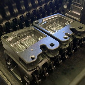

A group of PR-A2 parachute release cases in the process of machining. These prototypes were machined from solid billet of 17-4 PH stainless steel.

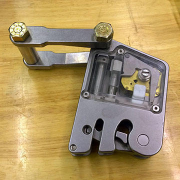

The assembly was a parachute-disconnect device for dropping skids of material from aircraft. Attached between payload and parachute, the device would release the parachute seconds after landing, thereby preventing any breeze from dragging the payload.
The assembly required 21 machined components, including a pocketed case that holds most of the parts. After machining prototypes, the shop filled an order of four units from specified materials.
Machining the case from 17-4 PH stainless steel billet was a challenge initially, because passes of 0.060- to 0.080-in. depth rapidly wore out the tips of tool inserts. The completed units passed testing, and the customer placed an order for 10 more.
“Our [CAM software] representative heard of our tool wear problem and introduced the GibbsCAM VoluMill™ module,” said Chatwood. “With [that module] we were able to increase cutting depth, use a lot more of the insert, and distribute the load on the cutter. Inserts lasted five times longer, and we removed more material in less time. Including the time saved from changing fewer inserts, we finished the job in about half the time.”
The units passed second-level testing, and the shop received an order for 30 more. Additional testing in desert and near-arctic conditions demonstrated a 99 per cent success rate, much better than the 75 to 80 per cent rate competing units could achieve.
The assembly is now Airborne Systems’ PR-A2 parachute release.

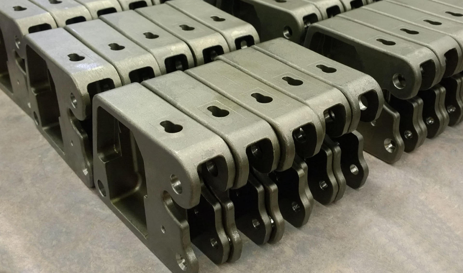

When all the prototyping was completed, the shop received an order for 100 units, at which point it became economical for the customer to provide castings of the cases for machining. Since then the shop has received repeat orders of 100 units, one of the few “production” jobs that the shop does.
Before accepting these orders, the shop carefully negotiates delivery so that work can be balanced without compromising other jobs while the larger order flows through the shop. To date, over 1,000 units have been made.
The Machining Center machines all the precision plastic, bronze, and stainless steel parts for the cargo parachute release, leaving final assembly for the customer.

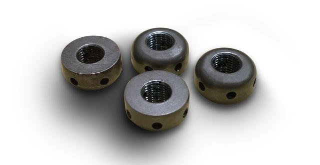

The nuts that go into the PR-A2 are made in single setup on a Nakamura-Tome multi-tasking machine with a Y axis and live tooling.
