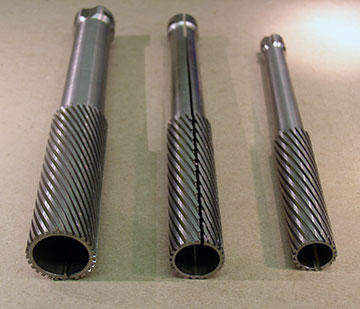

Parts from the Sunnen CGT Krossgrinding) honing tool family show the variation in size and number of machined grooves. The GibbsCAM plug-in made programming easier and automatic, and cut programming time per part by 1.25 hr.

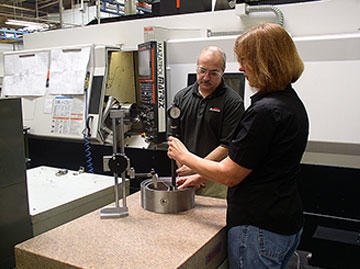

Tamara Hawn and Tool and Development supervisor Paul Nanney inspect a component made on the Mazak Integrex (behind them), for a “large bore diesel liner,” a fixture for a Sunnen customer honing system.
