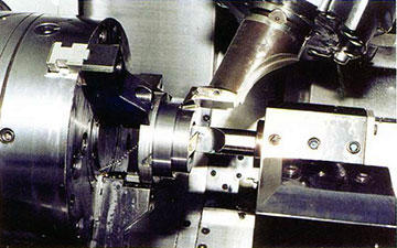

This close up of multi-axis turning center at Pacific Tool shows a part chucked in the main spindle, being bored by a tool mounted in the lower tool turret. A shoulder on the part OD is cleaned up by a tool mounted in the machine's tool spindle.
After evaluating the multitasking machines available, the shop purchased a Mori Seiki MT2000 multi-axis turning center from their local Mori Seiki dealer. "One reason for choosing the Mori Seiki machine was the excellent performance we've enjoyed from our more conventional Mori Seiki turning centers," Mr. Garbarino explains. "Also, this was our first experience with a multitasking machine, so we did not know what to expect. By buying the machine from our local distributor, we knew that we could count on a high level of support for the machine."

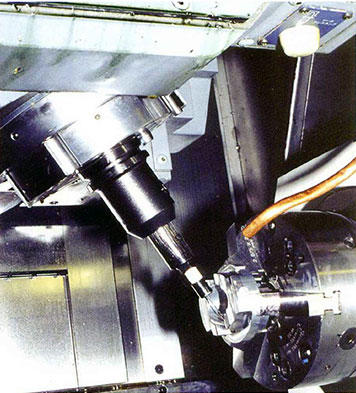

A small hole is drilled at an angle in the tapered inner wall of this compression tool blank using a small-diameter drill mounted in the turning center's tool spindle.
