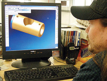

Zach Johnson reviews machined upper mount of film strip holding stand at Cobalt before generating code using GibbsCAM for the Mori Seiki turning center.

As examples of the Cobalt guidelines, Schule begins with one person he did not exactly train. “A year and a half ago, I brought in Zach Johnson, our senior programmer, who had nearly a decade of machining and programming experience. “Although he’d used other software, I told him he had to use GibbsCAM because I wanted standardization. He took the manuals home over a weekend, and taught himself. He’s a wiz with it, and he’s training others.”
Instead of programming conventionally with two to four passes of 1/4” to 1/8” depth, Switzer programs a single pass at full 1/2” depth with GibbsCAM VoluMill, which generates an efficient toolpath with a smooth pattern that Switzer leaves as the surface finish to demonstrate workmanship.
Johnson came to like the software and its time-saving tools. “That motto Gibbs uses—by machinists, for machinists— they’re not kidding,” he says. “There are so many little ways to do things, and it all makes sense.”
In two days, Johnson taught another machinist who had “zero programming experience,” to model in SolidWorks and program in GibbsCAM. “His first part, a hog-out with two pockets and four-axis work, was great. He was more surprised than I. If you know how to machine, and you have computer basics, you can program with GibbsCAM.”
A recent acquisition, a Mori-Seiki NL 2000SY, with two spindles, Y-axis, live tooling, tool setters, bar feeder, and parts catcher really tested their programming skills. “Until then, we hadn’t done turning work. It was intimidating,” says Johnson. “We added the GibbsCAM MTM module and that eliminated our fear.”
Johnson approaches GibbsCAM MTM as either milling or turning, and the software combines the operations into a single program. “I model in SolidWorks, which for me is the most difficult part, then load the model in GibbsCAM, and go straight to machining. I was making good parts in three days,” he says.

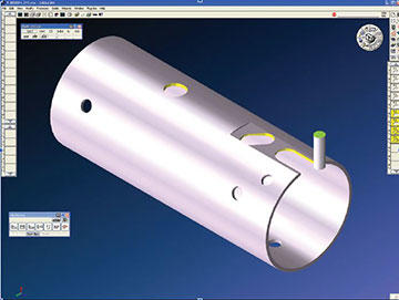

GibbsCAM Cut Part Rendering shows material removed in machining three pieces of each of four 5
The software and Mori Seiki machines allow Cobalt to take on complex, short-run work. Johnson describes a job contracted and delivered in one day. It required modeling and turning four different sizes and configurations of small parts, about 5" (127-mm) long, and from 0.625 to 1.75" (15.9–44.5 mm) in diam. He made them from bar-fed aluminum tubing, turning the ID and OD down to a wall thickness of 0.040" (1 mm). The parts were finished with drilling and rotary milling, and then slit sawed off the stock.
“I used the GibbsCAM MTM software, which has a lathe button and a mill button,” he explains. “I select one for turning, change my work from the X-Z plane for turning, to the Y-Z plane for milling, and select the milling button. The G-code for the switch is output automatically.”
One tool on which he relies heavily is Cut Part Rendering, which displays how a program cuts the part. “I do a few operations, then run the program. If I made no mistakes, I do more operations and run it again. Some parts have so many features that I can’t take risks. For a complex part, I’ll use it 20 times before I’m done. It’s why Cut Part Rendering is my best friend.”
He believes it works well. “My scrap rate is really, really low. Fred [Schule] likes that. If it takes me longer than estimated, he’s okay. When my programs hit the floor, 98% of the time they make good parts the first time.” He adds, “We don’t have a deburring department here. We don’t need it.”
