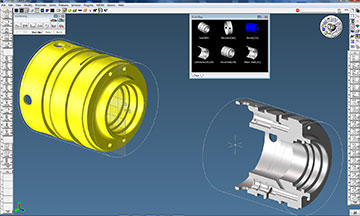

Another challenge is that Avmat receives no solid models, making most of its parts from blueprints, some dating to 1965, with the balance through reverse engineering. Mr. Vander Meyden says this presents no problems, because he uses GibbsCAM for all the modeling. Gibbs includes modeling so programmers can repair and modify geometry, make models machinable and simplify toolpath generation. “Our machines are configured in cells, with a PC at each station, so every machinist can use networked GibbsCAM to run simulations before machining and to improve the program,” he explains. “But I also use it to model every part, then use the model to program parts, and QA uses it to program the Zeiss CMMs.”
Before Kyle Vander Meyden programs a part with GibbsCAM, he uses its modeling capability to create a solid model to drive multi-axis MTM toolpath and for QA to program its CMMs. The drawing and solid modeling screen with active tool-process-machining palette and operations list enables seeing work on both main and subspindles.

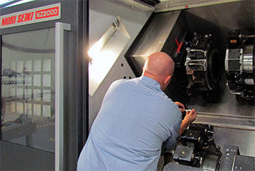

Kyle Vander Meyden using a hole test (bore gauge) to ensure holding a hole to the required ±.0003”, before continuing the machining cycle with a part transfer to the subspindle. With tolerances this tight, he measures every part in mid-cycle, to prevent losing a part to a chipped insert. When a tolerance is as loose as .010”, he measures every 20th part or so.

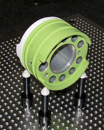

A skim cut on an upper bearing assembly – two mated halves machined together from aluminum-nickel-bronze. Because the material is unstable in machining, Vander Meyden programs a skim cut to within .010” of finish so the finishing pass keeps the part within the required ±.001” of roundness.
