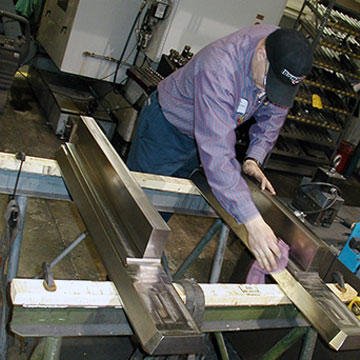

Jed Millikan, Norfolk Specialties, cleans these “clamp bars” after plunge roughing and finishing surfaces on a Milltronics RH30. Plunge roughing removed 278 pounds from the 665-pound, 4140 pre-hardened billet. Eight more operations – including drilling, boring, counterboring, countersinking and tapping holes at various angles – remove an additional 60 pounds, resulting in a finished component that weighs half as much as the raw stock.

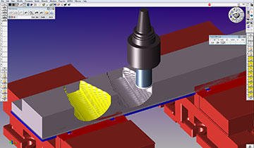

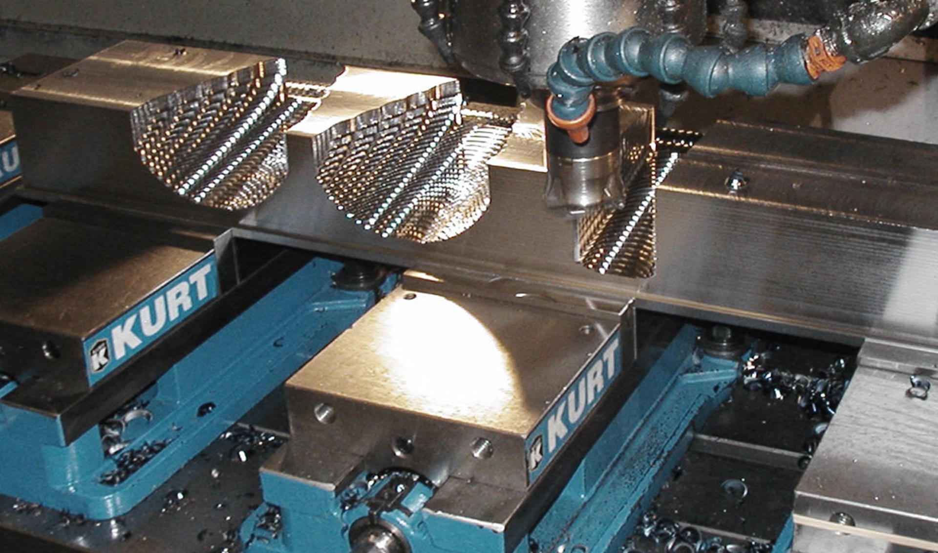

For example, one recent part at Norfolk involved removing 278 pounds of 4140 pre-hardened steel from a 665-pound piece of stock. The roughing stage often became a bottleneck, particularly on parts with irregular shapes. Both shops were able to alleviate this problem with plunge roughing because the technique removes material faster and places less wear and tear on cutting tools and machines compared to other roughing processes.
Essentially, it involves taking a series of overlapping passes that cut into the workpiece along the Z axis, similar to a drill. This improves stability and makes the process less prone to chatter and vibration. Additionally, eliminating side pressure from X- and Y-axis forces by keeping all cutting forces in the Z axis enables deeper cuts and more effective use of lighter (less rigid) and/or older machine tools.

While Mr. Wilson made an attempt at plunge roughing through manual programming, Randy Ouverson, owner of OEM, used fly cutting for roughing applications before the release of the latest version of GibbsCAM. In addition to lengthy cycle times, this strategy led to constant insert chipping and vibration that threatened to damage machines. “I knew that plunge roughing is popular for pockets, cores and cavities, but I hadn’t considered it for my parts. It turned out to be a perfect application,” he says.
Mr. Ouverson upgraded to the latest version of the software at the recommendation of his GibbsCAM Reseller, which he consulted about a difficult steering component order. The challenging part was a custom knuckle that began as a 10-by-12-inch plate of 1018 steel measuring 6 inches thick with a 6-inch-diameter hole flame-cut through the center. The knuckle required a great deal of material removal—the 190-pound initial stock would be machined into a finished component that weighed in at only 18 pounds.
A 2.5
Two setups were required to machine the top and bottom of the knuckle. To rough the first side, the shop used a 2-inch-diameter end mill with 14 double-sided inserts mounted on a 50-taper Tree 1260 machining center. Even after adjusting feeds, speeds and cutting depths, roughing the first side took 2 hours. Chatter and chipped inserts resulted in tooling costs of $98 per part. Moreover, side pressure on the part led the shop to tighten the vise excessively, putting it at risk for damage.
The shop had roughed only two of the parts this way before vibration loosened a fitting on the drawbar, preventing the release of the tool. However, with GibbsCAM’s plunge roughing routine and a 2 1 /2 -inch-diameter, 4-inch-long Sandvik plunge mill running at 1,000 sfm and a chip load of 0.008 inch, the shop reduced machining time to 1 hour and tooling cost to $12 per part. “More importantly, I think it saved my machine,” Mr. Ouverson says. “A side benefit we discovered is that corner radii cut cleanly with plunge milling, whereas fly cutting chirps, chatters and then chips the inserts.”
