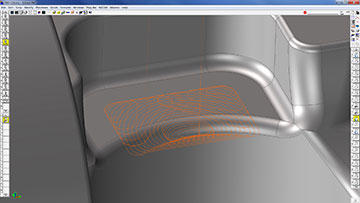

Precimax Simulation Programmed in GibbsCAM

Kool has been surprised over and over by what advances in software have allowed his team to do “With the GibbsCAM program, one of the biggest benefits we’ve seen is through using VoluMill for GibbsCAM,” he notes. “I’m old school – I trained on manual machines, so I figure if you want to remove a bunch of material, you get a face mill and you rip a bunch of material off. But my guys, using VoluMill, have proved to me over and over again that with an end mill buried as deep as you can go, the volume of material you can remove is better than a face mill. It’s hard for me to get my head around that, so I tell them to prove it – and they do, every time. We use Haas machines for milling, and using a half-inch end mill with VoluMill we can remove material like a face mill would on our high-end Mazak.”
“Depending on the part, that’s been a huge advancement,” he continues. “And you’re using the whole end mill. We just had a part that was 16 feet long when it’s welded together, 2.25 inches diameter in Inconel. We had to cut the whole center out, so you have two spars on either side with a hole running down each one of those spars. The center’s milled out of it, and I think we went through 100 end mills. But conventionally, if you were to use a half-inch end mill you’d only be using a half inch of that end mill to do your milling. Well, we’ve used all of it. It is dull from the tip to the shank, and there’s a lot of carbide laying on the floor when we’re done.”
The killer for end mills in corners is you get interrupted cuts, or you get a change in material volume that you’re removing. When you go into a corner, the tool wants to screech because you’ve gone from cutting along 20 degrees of the end mill to a full 90 degrees in the corner. “The thing will just howl,” says Kool. “The great thing about VoluMill is that it calculates what the pocket is and maintains the same volume of material removed by programming a path. Sometimes the path looks goofy but it’s maintaining volume. The chips are all the same weight, shape, size, and so you increase the life of your tools quite a bit.” And the team at Precimax readily accepts the new technology.

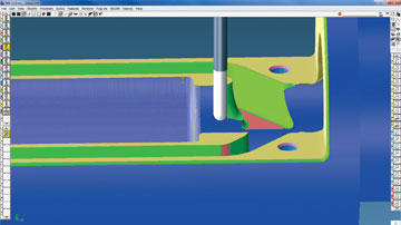

Toolpath simulation in GibbsCAM

GibbsCAM simulation allows to check for errors before the part is cut on the shop floor
