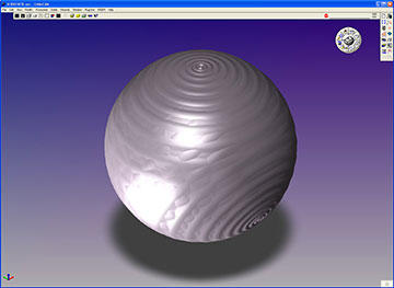

Autodesk Mechanical Desktop model of the sphere and ripple pattern supplied by Tom Shannon. GibbsCAM imported the model, which Blue Chip used to develop and program toolpaths.

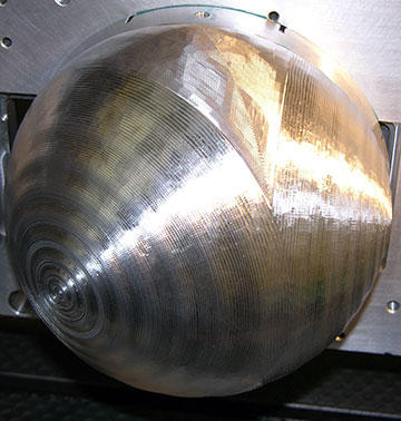

From an 8-inch diameter billet, a CNC lathe formed the inner surface of each hemisphere, roughed the exterior, machined a flange to mate the halves, bored 8 holes on the flange for locating pins to achieve registration between the two identical hemispheres, and tapped 8 holes for 10-24 screws.
GibbsCAM visualization module Cut Part Rendering, showing toolpaths. The machined pattern cut on hemispheres appears continuous on assembled sphere.
Each part was bolted to a mandril with the threaded holes, and fixtured for surface machining. Because the weight requirement was so restrictive, the wall thickness had to be reduced to .040". Finally, the triple pattern was cut into the surfaces such that the design appeared to be machined as a one-piece sphere, continuous and perfectly matched when the hemispheres were mated. For a good finish, they used a 1/4" poly-crystalline diamond ball end mill and polished the surface to a mirror finish.
Blue Chip made the hemispheres, and sculptor Tom Shannon mounted rare-earth magnets inside, assembling them into spheres, which he floated on magnetic bases of his making to create the sculptures. An .018 diameter, metal cable “tether” centered each sphere above its base to prevent its wandering away from the magnetic field and falling if bumped.

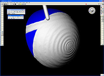

GibbsCAM screen shows the toolpath being cut by the ball end mill, using the Two-curve Flow Option, where the first “curve” is a point and the second, a circle.
