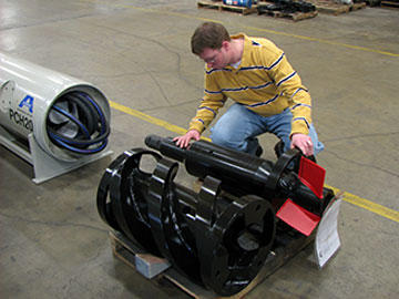

Design engineer Nathan Lindeman makes a final inspection of the swivel assembly of a guided boring machine. In the foreground is the auger weldment incorporating an end cap produced via four-axis machining and an auger flighting produced via Y-offset, four-axis machining.

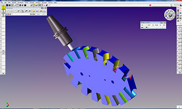

The machining of the bearing cage provides one example of how the company uses this capability. With the rotary fourth axis, two bearing cage sections can be machined in a single setup from a single, flat block of ductile iron. First, both sides of the block are faced. Then, profiling proceeds on the two outer edges to create radii that will eventually form part of the bearing cage OD. The stock is then moved to the rotary fourth axis. There, all bearing seats on one radius are bored before the part rotates 180 degrees for boring on the other radius. Finally, the workpiece is laid flat on the table for milling operations that create the ID portions of the two segments and separate them from the original block of material.
This screenshot from GibbsCAM’s Flash CPR (Cut Part Rendering) toolpath verification feature depicts the machining of two bearing cage sections. The machine’s fourth rotary axis enables machining the bearing cavities on both edges of the workpiece in one setup. As shown here, users can direct the software to display each operation in a different color.

In some cases, using the five-axis CAM system to program the rotary fourth axis does more than just simplify production of complex components. In fact, some parts would be impossible to machine without it. For example, Akkerman recently developed a new cutter head with an integral swivel for its tunneling machines. The shop ran into trouble in its first attempts to machine a complex, helical flighting for the cutting head’s auger. “It was Aron Bishop who made it happen, using the rotary fourth axis programmed with GibbsCAM five-axis,” Mr. Lewis says. “Without that combination, we would not have been able to make the part.”
The helical flighting begins as a 5,500-pound cylinder measuring 31 inches long and 16 inches in diameter with a wall thickness of approximately 5 inches. First, the ID and OD are turned in a lathe. Then, a machining center cuts five helical grooves through the cylinder’s wall. At this point, the cylinder essentially consists of six separate helices attached at the ends. Subsequent sawing separates the pieces, three of which are welded to end plates and a central cylinder to form the auger.
Mr. Bishop programmed the first part manually. At that point, the shop had not yet invested in five-axis programming, but it was using the rotary fourth axis for the helical cuts. During that operation, he discovered a problem. “Cutting on center resulted in a cross section that was narrower toward the center. It was like a pie segment, not the rectangular cross section that the part required,” he explains. “I knew we would need to cut along the Y axis, but off center.”

That was when Akkerman added the GibbsCAM five-axis option. This would enable the company to program four-axis work, offset in the Y axis and provide full control to the tool axis for parts with sufficient complexity to warrant surface milling strategies or where surface contouring is desirable. With the ability to offset in the Y axis, the shop could successfully machine the auger flighting with the proper cross section.
