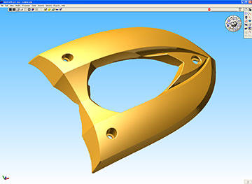

The back side of the passenger seat bracket as it was imported into GibbsCAM.
GibbsCAM’s Cut Part Rendering allows the machining process to be simulated and visually verified.
The front side of the passenger seat bracket as it was imported into GibbsCAM.

Jasmer relies heavily on Gibbs CAM SolidSurfacer to create toolpaths directly on the solid models from Pro/Engineer. An example of the key role Jasmer plays when it comes to prototype work is the bracket used for holding the passenger seat onto the back fender of the new Vegas Jackpot. As part of a custom-look bike, the bracket has to look custom as well because riders may not want to have the passenger seat mounted on their bike all the time. Simply placing exposed bolt holes on the fender was out of the question for the custom look Victory Engineering wanted for the Vegas Jackpot.
The challenge with this particular bracket is that it’s a fair-sized part (about 13 in. long by about 10 in. wide) yet only 0.100 in. thick except for some gusseting. Almost every surface of the bracket is contoured, with the only flat surfaces at the bottom of the counterbores and the seating surfaces on the opposite side of the counterbores. Since it is also meant to be chromed, the bracket required an excellent finish that wouldn’t require a lot of sanding or polishing. As a prototype machinist, it’s more important for Jasmer to spend his time programming the next part and let the CNC machine produce a finish that requires minimal handwork.
For the contoured surfaces on the bracket, Jasmer used GibbsCAM SolidSurfacer to compare different options with contour cutting but settled on lace cutting with an extremely small variable stepover that machined faster than contouring and gave the finish he was looking for, especially along the edges. GibbsCAM made it easy for him to try different machining strategies, compare cycle times, and run the Cut Part Rendering process simulation to compare finish quality before adopting the ideal process for creating the part.

“On this part we have a couple of deep V-grooved areas where we ran into some issues,” comments Jasmer, “I made up the first prototype and then we sent it out to be chromed. We discovered that some of the radiuses were so tight and some were so deep that we had difficulty getting the chrome into those areas. On some of the steep grooved areas I used a 3mm or even a 2mm ball end mill to get down into tight areas. Of course, it had to clean up well so we could chrome it. With GibbsCAM’s Cut Part Rendering simulation I could really see what the tool was going to do and whether I was going to end up with a little mark where the tool stopped.”
Jasmer ended up making several different revisions of the bracket before the chrome had the trademark quality look of a Victory motorcycle. Since GibbsCAM is a process based CAM system, multiple part revisions were no problem. GibbsCAM allows users to build their own libraries of standardized processes and then reuse them for subsequent jobs. Standard processes improve consistency and overall job quality. GibbsCAM’s full associativity between geometry, processes, and operations also supports multi-process programming, so a full range of applied processes can be stored such as multi-process hole making or pocketing operations.
