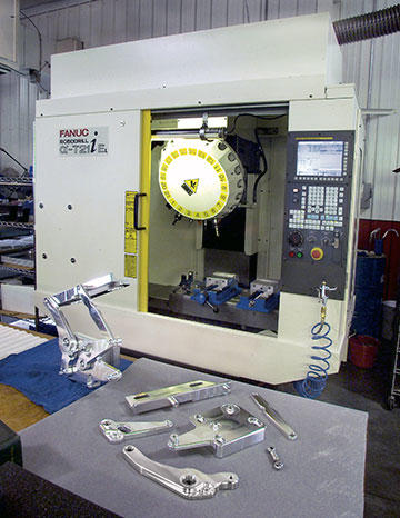

The resto-mod is thoroughly documented in Build Book #5, published by Team Killeen of Sherman Oaks, CA in 2007. GibbsCAM (and a 21-tool, 3-axis Fanuc Robodrill CNC machining center) are featured and credited for the machining of over 30 assemblies from 6061- T65 aluminum billet, many of them prominent in the award-winning Reactor.

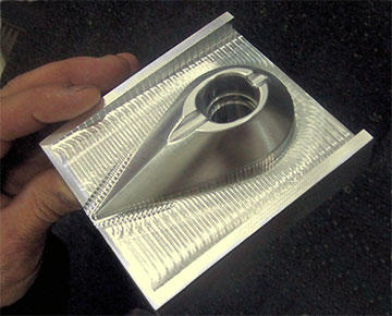

Here is the visible side of the hood pin locking plate, showing the machine finish achieved with GibbsCAM programming for the Fanuc Robodrill.

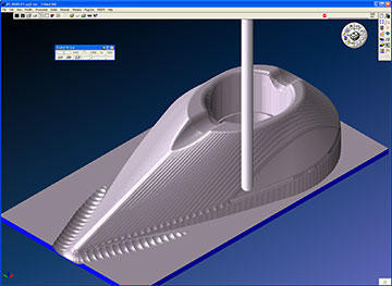

Virtual machining of hood pin locking plate with GibbsCAM Cut Part Rendering, which displays material removal, toolpath motion and part finish.
When the Prime Components partnership was formed in 2005, they bought SolidWorks, GibbsCAM SolidSurfacer and a CNC machining center. They chose the Fanuc Robodrill for its small foot print, its work envelope and the Fanuc control, which facilitated surface machining. “The machine is small,” says Milanowski, “but with direct drive and its high torque, the machine is good for high-speed machining techniques like lighter cuts made at high feeds and high RPM with rapid motion.”
GibbsCAM had been Milanowski’s choice for its extensive capabilities and ease of use. However, he purchased the SolidSurfacer module, which is much more capable than the entry-level version he used previously. He had n ever done surface machining with GibbsCAM, but anticipated having to design and machine parts with multiple flowing, intersecting and aerodynamic surfaces.
For the Reactor, he designed most of the machined parts based upon the machine’s specifications and the tooling he had, having to purchase few additional tools.

The machine finish Todd achieved enabled using the part without plating. Since plating was chosen, the part required minimal hand finishing.

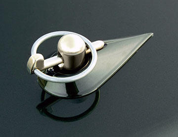

Completed hood pin assembly, as mounted on the Reactor, showing the hood pin coming through the lock plate, the lock pin and retaining ring.

Milanowski admits that Cut Part Rendering, the visual verification feature of GibbsCAM, had always left him apprehensive, but that verifying and machining this part gave him confidence. “The machining routines ran on the machine just as they did on screen,” he says, “I rely on it now. It really
cuts time and stress off complex parts.”

The Cut Part Rendering feature helped Todd ensure clean cuts, without gouging, in creating what he considers the most difficult part to develop for the Reator, the upper side air scoop. The two outer sections serve as the exhaust ports, leaving the center, two-port section as decorative.
He modeled the plate and a fixture in SolidWorks, then took the models into GibbsCAM to generate toolpaths with lace cut and surface flow machining. “Without GibbsCAM, there was no easy way to do it,” Milanowski elaborates, “There isn’t a flat surface anywhere. I selected faces I wanted to machine, chose cutting methods (lace cut or surface-flow), some other constraints, and then set my step-over distance for a .0002” scallop, and a speed of 10,000 RPM and 180 inches a minute for finish passes, and let it rock. It’s pretty amazing. Because I use the software’s Cut Part Rendering to visually check all my machining, the parts were perfect and ready for installation right off the machine.”
Without CAM, the job would have required unreasonable hours of hand work. “I wouldn’t have been able to do this without SolidSurfacer and Cut Part Rendering because the whole part is a combination of tangential surfaces,” says Milanowski. “When I started using Cut Part Rendering, I was skeptical, not knowing its accuracy. Now I have complete confidence in it, and I use it for everything.”
